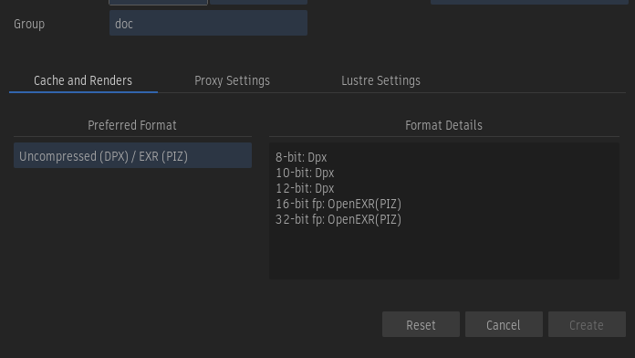

Use
Preferred Format to set your storage preferences.
Tip: The Export window displays an asterisk next to the compression of file sequence export whose format matches the current Cache and Renders. This simplifies the use of Link Media when exporting.
Format Details
Format Details displays the formats used to store cache and renders for each bit depth.
DNxHD supports resolution up to HD (1920x1080); anything higher is encoded in DNxHR.
The available compressions vary by operating system.
