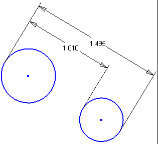

The proximity point arguments are required whenever a circle or arc is input. This point specifies which of the two possible solutions is used when creating the constraint. The figure below illustrates two tangent distance constraints placed using the same input arguments except the proximity point for the smaller circle indicated the position closer to the large circle in one case and further away in the other.
