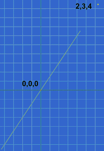

Creating a WorkAxis
The following code creates a WorkAxis and adds it to the WorkAxes collection. The AddByTwoPoints method is used, so another WorkPoint is defined with X Y Z values of 0, 0, 0. So the WorkAxis will be defined by two points; the previously created WorkPoint at 2, 3, 4, and a new one at 0, 0, 0.
Dim oWorkPoint2 As WorkPoint
Set oPnt = oTrans.CreatePoint(0, 0, 0)
Set oWorkPoint2 = oPartCompDef.WorkPoints.AddFixed(oPnt, False)
Dim oWorkAxis As WorkAxis
Set oWorkAxis = oPartCompDef.WorkAxes.AddByTwoPoints(oWorkPoint1, oWorkPoint2, False)
The AddByTwoPoints method creates the WorkAxis and adds it to the WorkAxes collection. Note the third argument again indicates that the newly created work feature should not be considered application-specific construction geometry. It is displayed on screen, appearing something like this:

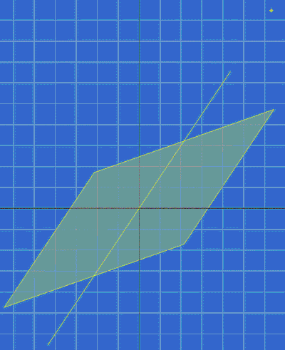

Creating a WorkPlane
With just two points, there is insufficient information to create a plane. There are a number of different methods to generate planes - for example, by using a third point, or through an axis, with the plane angle relative to another plane. The following example uses this latter method. Note that one of the predefined WorkPlane objects, the Y-Z plane, is used as a reference plane from which an angle of 45 degrees is measured.
Note: This code also demonstrates the ability to name work features. When dealing with a large number of objects, it is easier to reference them by name than by numerical index. The same applies to the base work feature objects. The name of the Y-Z plane, the first one in the WorkPlanes collection, is YZ Plane. This could be referenced as Item(1), but it is easier to read as Item("YZ Plane").
Dim oWorkPlane As WorkPlane
Set oWorkPlane = oPartCompDef.WorkPlanes.AddByLinePlaneAndAngle _
   (oWorkAxis, oPartCompDef.WorkPlanes.Item("YZ Plane"), 45, False)
oWorkPlane.Name = "MyFirstWorkPlane"
The last line of code names the newly created WorkPlane object MyFirstWorkPlane. Other code can use this name to reference this work feature. The new name is also displayed in the Autodesk Inventor browser, provided the work feature is not application-specific construction geometry. It is displayed as follows:
