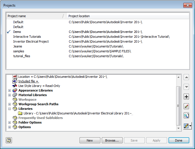

The Electrical Catalog Browser for Inventor allows you to insert 3D parts by selecting a catalog value from the database. The utility includes the Catalog Browser interface, the link to the AutoCAD Electrical database, and a sample set of 3D electrical parts. The default location for the sample parts is C:\Users\Public\Documents\Autodesk\Inventor Electrical Library [release]. Include this library path in your project libraries or use the Inventor Electrical Project installed with the Electrical Catalog Browser.

Parts are associated automatically when you select a catalog record in the Catalog Browser and browse to a part for insertion. The part must be in a folder included in the Libraries definition. The next time you select the catalog record, the part is available for insertion.
