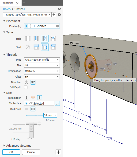

User Interface Enhancements
The Hole command provides a streamlined workflow and hole presets for easy re-use.
| Streamlined Workflow |
The property panel workflow is top to bottom. That is, any property you set or change can affect the properties in sections below it, but those properties do not affect the properties in preceding sections. Improved dimension order allows faster value entry for holes. Presets allow for creation and re-use of often used property sets. |
Breadcrumb
Breadcrumbs aid in feature creation and edit. In the image (left), a hole feature (Hole3) is being edited, you can click on 'Sketch4' to edit the sketch or you can click on 'Hole3' to edit feature defining parameters. |
Expand/Collapse
Panel sections can be expanded or collapsed to suit your use, personalizing the use interface for often or seldom used parameters. Panel sections remember the last used state between uses. |
| Panel menu
The drop down provides access to Help and other advanced settings. The menu adjusts based on context. For example, one list for the property panel, one for the model browser, and so on. |
