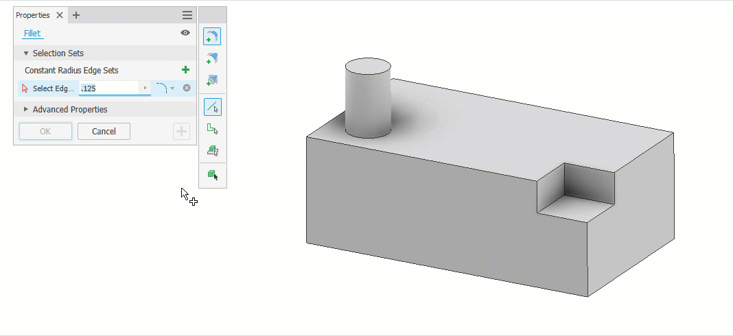

		The fillet command is moved to the property panel framework and divided into three commands - Fillet, Face Fillet, Full Round Fillet. Legacy fillets are migrated to the appropriate type. Legacy fillet names are not modified during migration.
- Fillet
			 For more information, see
				To Create Edge Fillets.

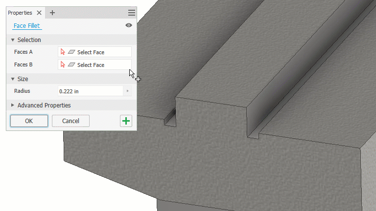

- Face Fillet
			  Adds a fillet feature between two non-adjacent faces of a single solid. If there are contiguous features, these are capped and filled to create the fillet.
				To Create Face Fillets.

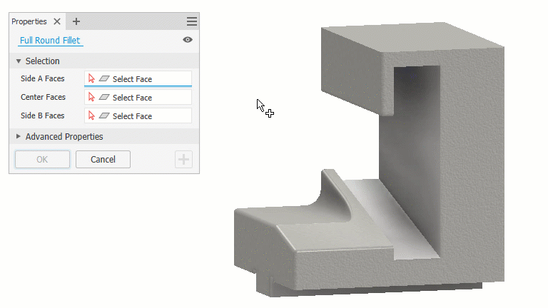

- Full Round Fillet
			  Adds a fillet feature tangent to selected faces or sets of faces.
		  To Create Full Round Fillets.
