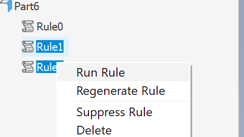

Select multiple iLogic rules
In the iLogic rule browser, you can now select multiple rules to perform the following operations using options in the context menu: Suppress Rule, Unsuppress Rule, Run Rule, Regenerate Rule, Delete Rule.

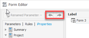

Undo, Redo options in the iLogic Form Editor
The Undo and Redo buttons are now added directly to the Form Editor dialog. You can also use the shortcut keys (Ctrl-Z and Ctrl-Y) for these operations.
