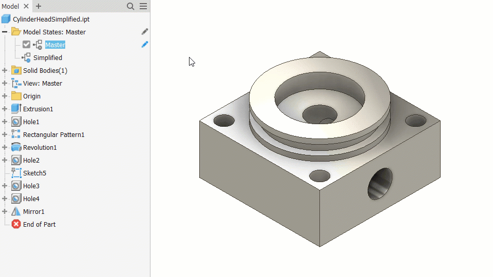

A powerful new workflow called Model States is added this release. Model States let you create manufacturing states, simplification levels, and more in the same part or assembly file.
Model States represent the implementation of some of the most highly requested functionality In Inventor. You can now create multiple representations of a part or assembly within a single document. This new workflow provides a convenient way to engineer, manage, and manufacture your designs. Because variations exist in one file, there is no need to worry about breaking associations between files.

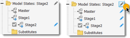

By changing the Edit Scope toggle in the browser, you can decide if edits apply only to the active member or all members.
Use part model states to capture manufacturing processes, create part families, create adjustable and flexible parts, or create simplified versions of a part.
Each Model State can have unique parameters, properties, and suppression states.

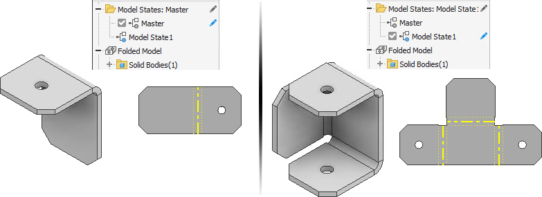

Sheet metal parts also benefit from model states. By using Model States you can now create configurations with unique folded features and flat patterns.

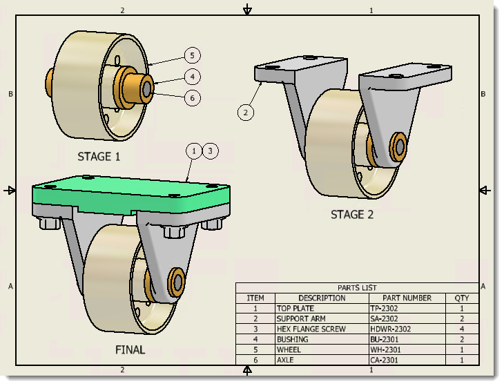

You can select a model state when creating a drawing view. A Parts List displays the selected model state members and their iProperties.
A view created from a Substitute model state reflects the state of the substitute part in the drawing view.
