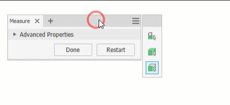

Tool Palette

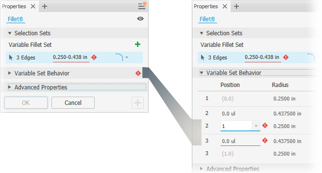

Warning Notifications
For more information, see About Property Panels.

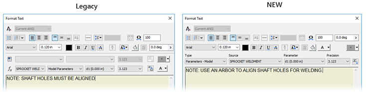

 Text Rotation moves up a row
				 Text Border moves up a row
				 Text Box (Sketch text only) moves to the left of the Color control

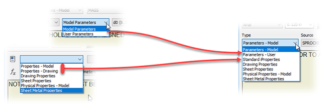

				 Symbol list moves up with other formatting controls
				For more information, see Format Text Reference.
For more information on Sketch text, see To Work with Sketches.
