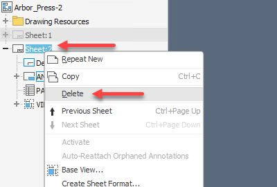

Delete sheets using the Delete key
When deleting sheets, you can now also use the Delete key in addition to the already existing Delete command accessible from the context menu. Note that this command was called "Delete Sheet" previously.
For more information, see To Work with Drawing Templates, Sheets, and Sheet Formats.

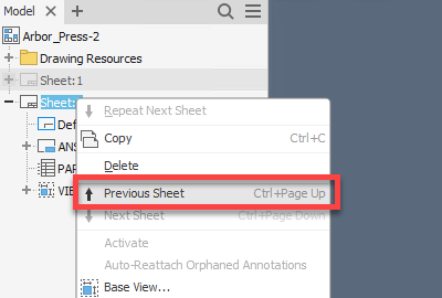

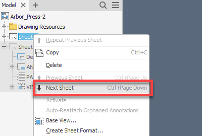

Browsing through multiple sheets
In the earlier Inventor versions, you had to double-click the sheet to activate it. Now you can browse through several sheets in a drawing using the Next Sheet or Previous Sheet commands starting from the selected sheet. If desired, you can assign the shortcut keys to these commands.
For more information about Drawing Sheets, see To Work with Drawing Templates, Sheets, and Sheet Formats.
