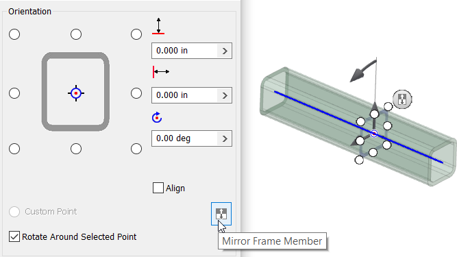

Frame Generator Enhancements
For more information on changing frame members, see Modify base frame members.

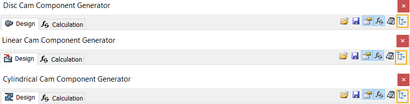

Design Accelerator Enhancement
Several component generator dialog boxes, as shown below, are enhanced to support inserting a component into the main assembly: This lets you insert a component as a single part directly into the main assembly. Previously, these components could only be inserted as a sub-assembly. In the dialog box, click Enables/Disables the sub-assembly structure to toggle between inserting a top level component or a sub-assembly component.
Power Transmission panel
CAM commands
For more information on creating Cam components, see Design disc cams, Design linear cams, and Design cylindrical cams.

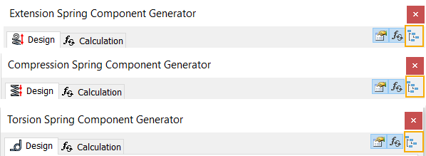

Spring panel
Compression, Extension, Torsion Spring commands
For more information on creating Spring components, see Design compression springs, Design extension springs, and Design torsion springs.

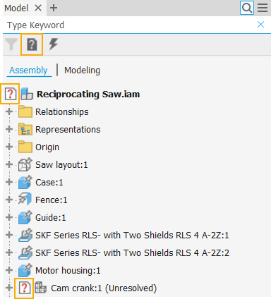

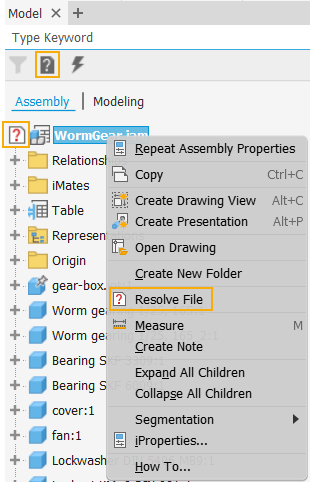

Unresolved Icon Enhancements
The unresolved icon and the Resolve File context menu option are enhanced as follows:
For more information on resolving files, see To Resolve Skipped Components in Part and Assembly Files.

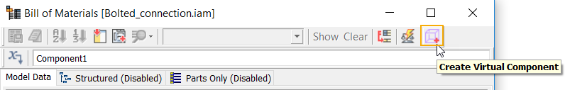

Bill of Materials (BOM) Enhancement
Use the new option, Create Virtual Component, to create a virtual component from the Bill of Materials dialog box. The virtual component appears at the bottom of the assembly browser.
For more information on virtual components, see About Creating Parts or Virtual Components in Assemblies.

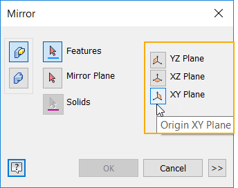

Part Mirror Enhancement
The workplane options in the part Mirror dialog box, available from the ribbon 3D Model tab
Pattern panel
Mirror command are updated. The workplane options now display:
For more information on using the mirror command, see To Arrange Part Features in Patterns.

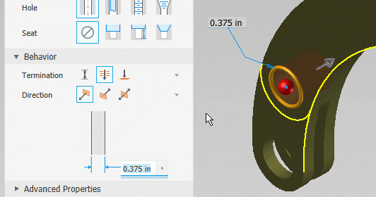

Hole Command
When placing holes, you can control center point creation by toggling the
Allow Center Point Creation
option. When OFF input accepts existing sketch-based geometry only. When ON, input is not restricted to sketch geometry.
For more information, see To Create Holes.
