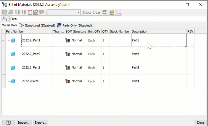

Bill of Materials
You can now select multiple cells in a column and change the text in all cells at the same time.
Select multiple cells in a column (any method), press Delete key, the contents in all selected cells will be deleted, (does not delete Read-only values).
