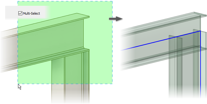

Change member selection
Previously, window selection was not available when you used the Change command. Window selection is now enabled, and you can select multiple members at the same time using the Multi-Select option.

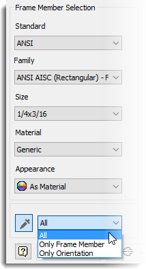

Copy Properties
You can now copy information from existing frame members when you use the Insert and Change member commands. Select the eye dropper in the dialog to enable copy properties and then select a member. You can choose to copy Only Frame Member information, Only Orientation, or both.

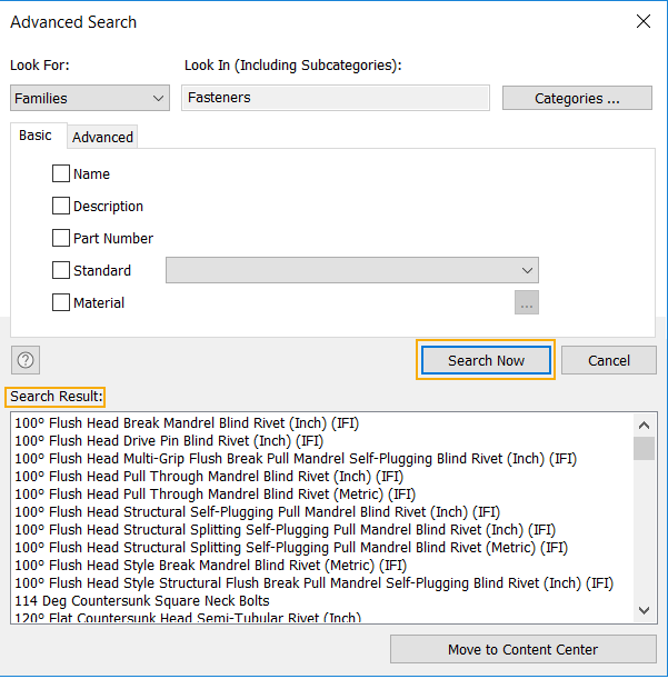

In addition, the Search Now button is automatically enabled when accessing the Advanced Search dialog box. Quickly execute your search by pressing ENTER after specifying your search criteria. The Search Result field displays information relevant to the active search.
For more information, see To Locate a Content Center Part in the Content Center library.

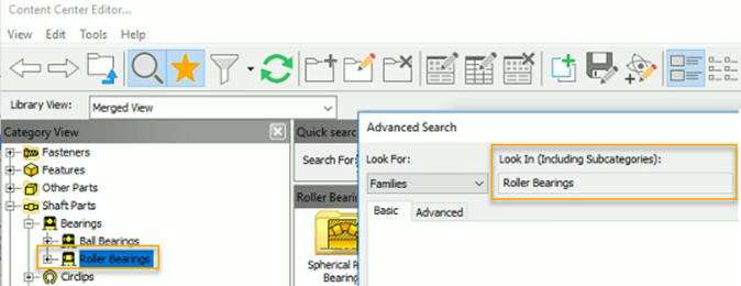

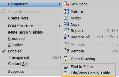

Find in Editor: The Content Center Editor dialog box opens to the location of the part in the Content Center library.
Edit/View Family Table:
The Family Table Editor dialog box opens with the family member selected. Here you can view a read-only family table or view and edit a read-write family table.

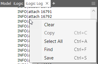

iLogic now provides a type of PRINT statement that can be used in rules. This new functionality, called iLogic Logging, uses new iLogic functions to send log messages to a new Inventor panel and also to a log file. In addition, there's a new automatic rule tracing mechanism. Rule tracing helps you to visualize when and why a rule is run.
Overview
To generate iLogic logs:
Windows panel
User Interface drop-down menu.

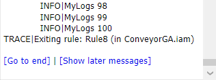

For example, add Logger.Info("Hello World") to your rule to generate the following when you run the rule:
Managing Log Messages in the iLogic Log Panel
The active log level controls which logging statements are actually logged. Start by setting the log level to Debug and including logger.debug("message") statements into your rules. Once you've finished debugging and you no longer need the Debug messages, then change the active log level to Info or to another level lower in the list. You don’t need to remove the logger.Debug statements from your rules. Subsequently, only Info, Warn, Error or Fatal messages will appear. This same behavior applies to all log levels. For example, if you change the level to Info, and the log panel is getting cluttered with Info messages, change the log level to Warn. The Info messages will stop appearing, and only the Warn, Error, Fatal messages will display. Setting the active log level allows you to display only the types of messages you need.
Navigation Links
| After you clear messages from the panel, navigation links display at the top of the panel if older messages are available. | The iLogic Log panel is limited to displaying 20,000 messages at one time. When over 20,000 messages are entered, navigation links at the bottom of the panel allow you access messages created after reaching the 20,000 limit. |
Rule Tracing
Rule-tracing is a new iLogic feature that helps you to visualize when and why a rule is run. Rule Tracing automatically logs messages when a rule is entered and when it is exited, as well as what triggers the rule to run. Simply set the active log level to Trace to see these messages. Set the active log level back to turn them off.

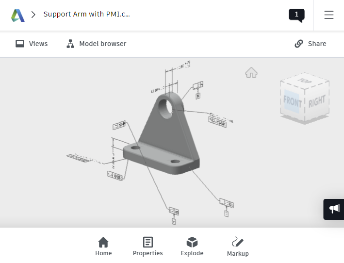

3D annotations are now shown in Shared Views and Fusion Team viewer.

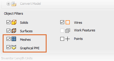

SolidWorks mesh data can now be imported. In the dialog Object Filters section, check the Meshes option to include meshes from the selected file. For information about working with mesh data, see About Working with Mesh Geometry.
STEP
You can now import graphical PMI data from a STEP 242 file by checking the Graphical PMI option.

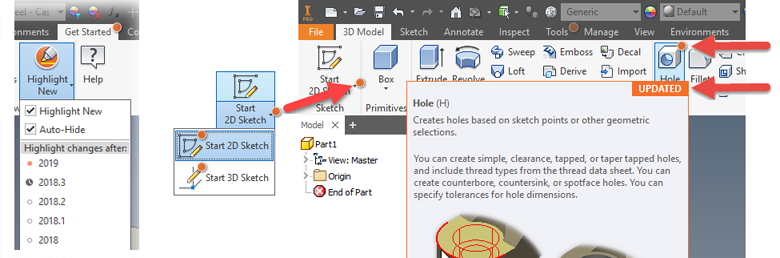

Highlight New for Ribbon based commands
When you turn on Highlight New, off by default, colored badges highlight the new or updated commands. This makes it easier for you to quickly explore new or updated commands you use in your workflows.
How can you use this feature? Imagine you were using an earlier version, for example 2018.2, and are moving to 2019. You select 2018 from the list and all new or updated commands after 2018.2 display a badge. That would be 2018.3, 2019, and 2019.1.

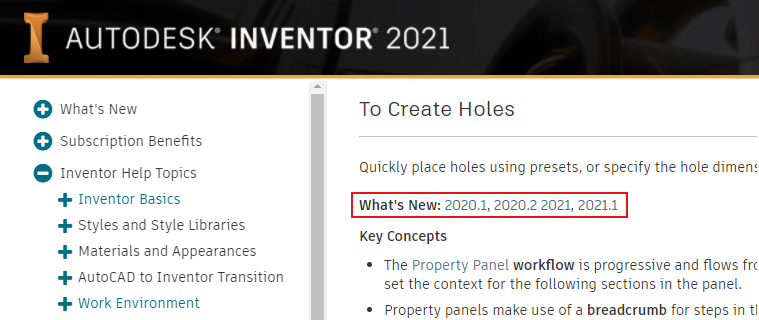

Additionally, when you use F1 to get to a Help page, where applicable, at the top of the page you will see links to the What's New topic explaining the change to the feature or command.
For more information see: To Work with New-Updated Badges

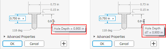

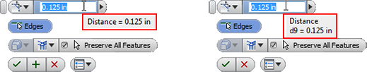

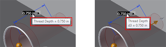

Value Fields Display Parameter Names in Tooltips
Value fields now display the parameter name in the tooltip. When you pause the cursor over the parameter name displays with the value.
Here are some examples comparing prior releases (left image) with 2019.1 (right image):

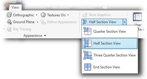

When you install Inventor you have the chance to Opt in to a data collection activity. Based on your Inventor usage data, the Half Section View is used most often in Parts and Assembly models. Therefore, with this update, the Section View command will default to Half Section for the first use in an Inventor session. Thank you for helping us get to the right setting for this tool. The Section View command can be accessed from both the View and Annotate tabs in part and assembly documents.

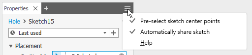

Panel Menu
The Hole command has new entries in the Panel menu:
Pre-select sketch center points - checking this option causes all unused sketch center points, in the active sketch, to automatically be selected for use by the Hole command, populating each center point with a hole.
(Create new hole), the sketch is automatically shared for use with creating the next Hole. If you do not use the sketch for the next hole or click Cancel or Esc, the sketch will be unshared. You can share a sketch manually by right-clicking the sketch browser node and clicking Share Sketch. Automatically share sketches is in the Part environment only.
