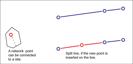

Use the Network Point Creation workflow to create any of the network point types.
The Network Point Creation workflow splits existing lines to keep the topology correct.
You can also double-click a point type to start digitizing with the current options.
If you create a new site, specify the geometry type for the site.
When you are finished creating geometry, the feature class form is displayed so you can add attribute data.
If you place the network point on a line feature such as a pipe, you are prompted to create a soft split or a hard split. For more information, see Split Lines.
