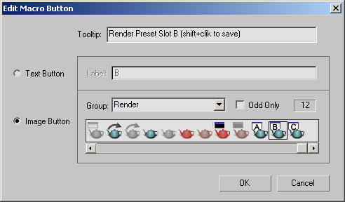

The Edit Button Appearance... option opens a new dialog whitewalls the user to control the appearance of the button including:
The Tooltip to be displayed when the mouse rolls over the button,
The Text Label when a Text Button is requested, and
The image file and the icon number to be used when an Image Button is desired.
This is the default appearance of the dialog. Eventhough the button is currently showing an icon (specified in the source code of the script), the dialog will provide the Text Button settings as the default state.
The user can switch the button mode to Image Button, select an icon library from the drop-down list (for example, "Render"), and select a new icon from the list:

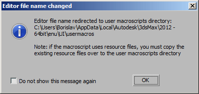

Note that opening a "factory" MacroScript that ships with 3ds Max will copy the file from the \macroscripts folder to the \usermacros folder in the current user's Local AppData folder to allow custom changes to the code. Scripts placed in the \usermacros folder will be evaluated after the factory scripts and will thus override them. The following warning will be shown by default (unless disabled via the checkbox option in the lower left corner):
