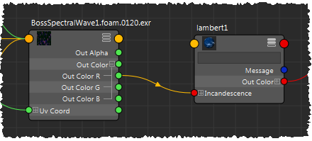

- Apply the map as a
File texture and use the values to drive the parameters of a shader as desired. For example:
