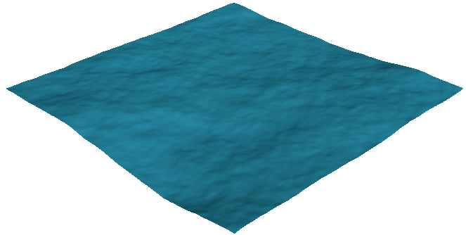

  6. Select the plane, and click Create Spectral Waves. For more information, see Add and edit BOSS solvers.
    There is no deformation yet, because the Start Frame is 2 by default.
  7. Advance to frame 2. You should now see the resulting deformation.
  8. In the BossSpectralWave1 attributes, set Patch Size X (m) and Patch Size Y (m) to 50. By matching the actual size of the plane in world space, you ensure that you do not waste computation time and memory by calculating deformation values for regions beyond the mesh.
    The deformation changes because the distribution of random numbers is different. In addition, the maximum vertical displacement is a bit smaller because longer wavelengths do not fit on the smaller patch.
  9. Play back the scene to see the animation.

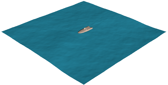

    The following steps will add a collider to interact with the surface deformation. See also: Adding a boat wake (video).
  10. Open the Content Browser. On the Examples tab, navigate to Modeling/Sculpting Base Meshes/Vehicles and import SportsBoat.ma.
  11. The boat mesh is too big for the scene, so scale it down by a factor between 0.01 and 0.02. You can delete the motor mesh.
  12. Animate the boat mesh to move from about –20 to +20 in the Z axis over 5 seconds (120 frames at 24 fps).
    For realistic results, you should use values that are close to real world velocities. In this case, an average speed of 8 m/s roughly corresponds to 16 knots, which is reasonable but not especially fast for a motorboat.
  13. Select the boat mesh, and then click in the Boss Ripple / Wave Solver window. For more information, see Add and edit BOSS influences.
  14. Play back again. You should see a wake behind the boat.
  15. Continue to adjust the settings and play back as desired.
