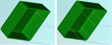

  1. Click create node (Geometry tab > Create > Create Node) and place a node at the baffle origin.
  2. Click create line (Geometry tab > Create panel > Curves > Create Line) and create a line from the node towards the part. End the curve a distance from the part that is at least equivalent to the diameter of the baffle.
    baffle curve
  3. Select the curve that represents the baffle. Click Geometry tab > Properties panel > Assign > New > Baffle.
  4. Enter the baffle dimension in the Baffle Surface Properties tab of the Baffle dialog.
  5. Enter 0.5 for the Heat transfer effectiveness (HTE).
  6. Select the mold material from the options in the Mold Properties tab of the Baffle dialog. If the baffle is encased in a different material to the rest of the mold, it is important to specify that material.
  7. In the Name box, enter an appropriate name for the baffle, then click OK twice.
