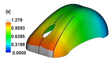

In this tutorial, you simulate the filling phase in a part. The feed system is not included. The filling phase is the most important phase of the injection molding cycle. If there are problems with the filling of a part, the part quality is not optimal.
Attention Download the files for this tutorial from Autodesk Knowledge Network-New User Quick Start tutorial.
In this tutorial, you will do the following:
  1. Create a project
  2. Import a CAD model
  3. Investigate different injection locations
  4. Set processing conditions and run the analysis
  5. View results
Fill Time
