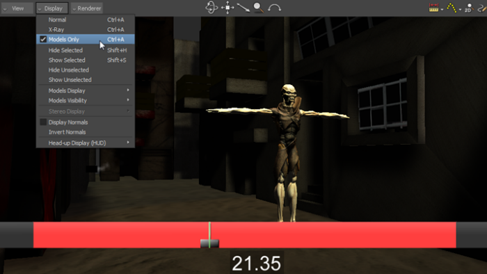

The following figure shows the Models-Only display mode.

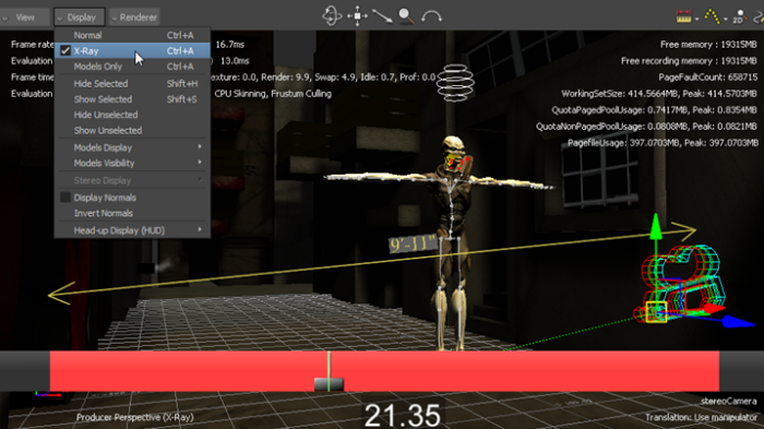

The following figure shows how the X-ray and Normal display mode draw extra elements in the viewport.

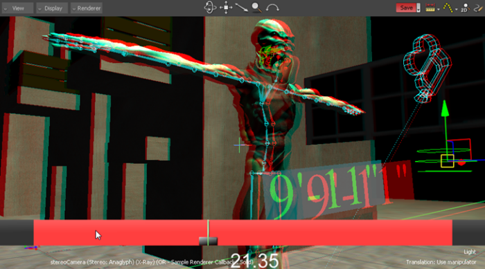

In the stereo display mode, the Render() function is called twice per frame/per view pane (once for the left and right eyes respectively), and composite both the buffers accordingly (if not using the active stereo mode).

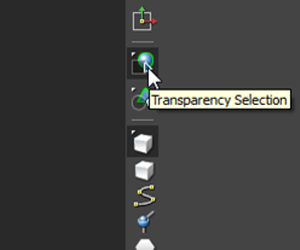

The Transparency Selection mode (as shown in the following figure) works only when the selected custom renderer’s SupportIDBufferPicking property is true.
