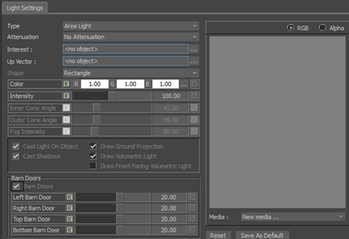

Many objects are updated to meet the needs of the higher quality renderers and to increase the pipeline interoperability with other DCC tools.
The light models now include more features such as, animatable barn door properties, spot light type includes inner and outer cone settings to create penumbra, and area light type (rectangle and sphere shapes) are available for soft shadow. The FBX file format can transfer these properties seamlessly to Maya and other DCC tools. The new light types and properties are shown in the following figure.
To enable the UI widgets setting for these new lighting properties, you need to turn on the FBRenderer::AdvancedLightingMode upon custom renderer object creation, or permanently by using Rendering
AdvancedLightinUISetting preference in the configuration file.
bool ORCustomRendererCallback::FBCreate()
// Enabled advanced lighting mode, include UI widgets for various advanced lighting
// setting, includes:
// Light: area light, spot light inner/outer angles, barn doors, and others.
// Model: PrimaryVisibility, CastsShadows, and ReceiveShadows.
FBSystem::TheOne().Renderer->AdvancedLightingMode = true;Currently, the default renderer does not use these new properties for viewport rendering.

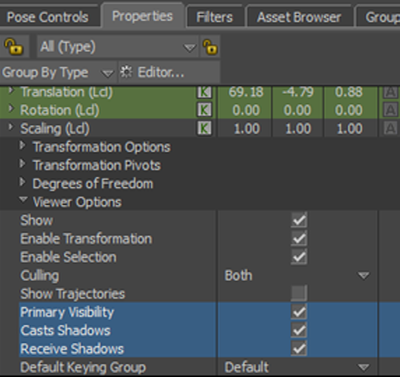

Three new properties are added to the models: Primary Visibility, Casts Shadows, and Receive Shadows. The custom renderer uses these properties to access the shadow setting for each model and align with other DCC tools. The following figure shows these properties for the Model object.
To view these new properties in the property editor, you need to turn on the AdvancedLightingMode (see the
!!CONVERSION WARNING!! broken xref detectd, likely a cross-book reference. The target GUID file is GUID-9094779E-7DD4-4D4F-9F71-1F04603938C9.htm#SECTION_D6ED2D483ED74C9481DD5FBC277AE8A0 and the target link text is Lights
section). You can also subclass FBModel to create a custom model type. For example, see

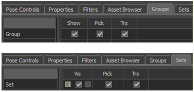

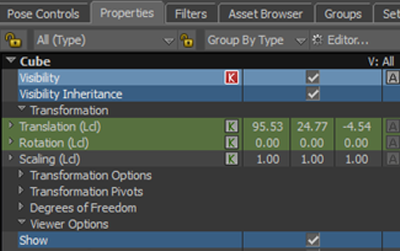

The following determine whether the models are displayed in the viewport:
The model’s Show property is off.
The animatable Visibility property is off.
Any node’s Visibility in the upper level parent/child hierarchy is off, and all the Visibility Inheritance properties in between the hierarchy are on.
Owner group's Show property and owner set’s Visibility value.
You can use the FBModel::IsVisible() function to get the visibility information at the current frame without handling this visibility determination logic.

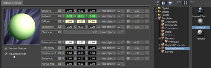

Most of the material properties are animatable color vectors, and you can also connect texture objects (FBTextrue type) to each material channel for mapping with the default UV set. For more information, see the FBMaterial class interface. A single material object can be shared by multiple models, and a single model can be mapped by multiple materials (if the underling geometry has multiple material regions).
The following figure shows the Material Settings pane. You can connect many properties in this pane to the texture objects.
As shown in the above figure, you can drag the material icon from the Asset Browser
Templates
Shading Elements, and drop it on a model in the viewport. MotionBuilder automatically creates a new instance of the material and connects it to the model (or replaces any existing material). The sample Python script in

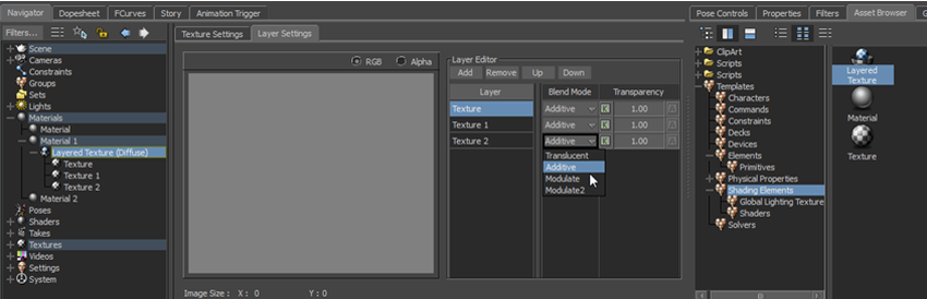

static bool RegisterExternalVideoFormat( const char* pFormatSuffix );Layered texture provides a simple and efficient way for real-time blending between the multiple texture layers. Each layer can have animatable properties, and it can refer to a static image, video sequence, or even live stream input. The following figure shows the Layer Settings pane.
By default, MotionBuilder supports Translucent, Additive, Modulate, and Modulate2 blending modes, but you can subclass the FBLayeredTexture class and extend its functionality easily. For example, see the sample in

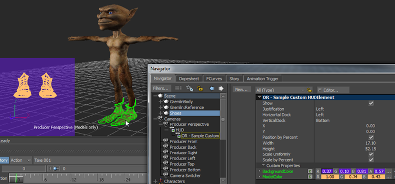

The HUD system is updated for a flexible layout, enhanced display quality through Scaleform technique, easier information retrieving (for example, you can reference any properties and get its current value displayed in the viewport), and for some common built-in element types (for example, Bloop Slate, Record Light, Timeline, and others). Please refer to the user's guide for more information.
You can also extend the default provision by subclassing the FBHUDElement class. For example, see the sample in
In the following figure, the sample custom HUD element shows a currently selected model in the viewport.
You can also create a custom FBManipulator to allow interaction with the HUD elements using mouse buttons and move operations in the viewport.
