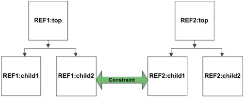

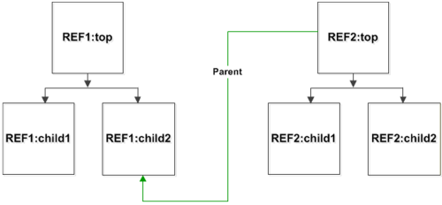

The following figures illustrate the connections that are allowed.
This figure shows an allowed constraint.
This figure shows an allowed parent connection.

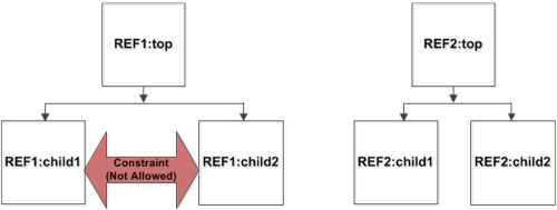

The following figures illustrate the connections that are not allowed.
This figure shows a constraint that is not allowed.

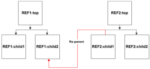

This figure shows a re-parent connection that is not allowed.

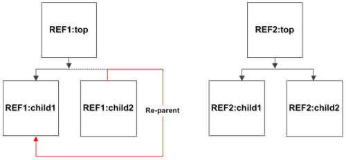

This figure shows another re-parent connection that is not allowed.
