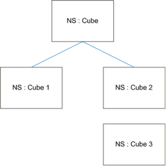

For example, consider a scene that contains a file reference object as shown in the following figure.
The following code sets NS:Cube, NS:Cube 1, and NS:Cube 2 to be the contents of an animation track.
