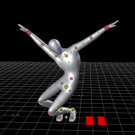

You can refer to this topic to gain a basic understanding of how to use Python in MotionBuilder. Additionally, some important classes and concepts are explained in this topic for understanding how to use Python.
The Dancing Man program described in this topic constrains a character's hip effector to the screen coordinates (x,y) of the mouse. At the end of this step-by-step tutorial, a character appears to dance in the scene when you move the mouse. The image below shows the result of The Dancing Man program.

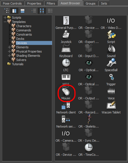

The FBCreateObject()
function is used to create objects from within the Asset Browser window. Following are the arguments of FBCreateObject()
Argument 1: "Browsing/Templates/Devices"
- The Asset Browser path. This path is illustrated by the node hierarchy in the navigation tree. This path must always begin with Browsing/
Argument 2: "Mouse"
- The entry name. It corresponds to the red circle in the following figure.
Argument 3: "MyMouse"
- The custom name of the object.

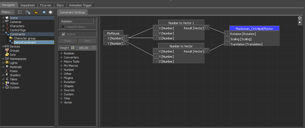

The following figure illustrates how the hips effector is constrained by the mouse. Instances of FBBox
and FBAnimationNode
are used in an FBConstraintRelation
to define the behavior of the constraint.
FBBox
Base ClassFBBox
is the base class of any animatable element in the scene including models (FBModel
), lights (FBLight
), materials (FBMaterial
), textures (FBTexture
), shaders (FBShader
), constraints (FBConstraint
), and so on. Our FBConstraintRelation
contains a set of FBBox
objects. In the figure, the boxes MyMouse
, Number to Vector
, Number to Vector 1
, and Plasticman_Ctrl:HipsEffector
are all instances of FBBox
. Each instance of FBBox
performs a specific role in the FBConstraintRelation
MyMouse
box acts as a data source.Plasticman_Ctrl:HipsEffector
box is being constrained.Number to Vector
and Number to Vector 1
boxes convert the X and Y data from the mouse into 3D vectors.The following code sample shows how to create these boxes and set their position in the Constraint Settings window.

# Create a mouse device and append it to the scene.
mouseDevice = FBCreateObject('Browsing/Templates/Devices', 'Mouse', 'MyMouse')
mouseDevice.Online = True
mouseDevice.Live = True
scene.Devices.append(mouseDevice)
# Create a constraint relation.
constraintRelation = FBConstraintRelation('DanceConstraint')
constraintRelation.Active = True
# 1. Create a box for the mouse's output.
mouseBox = constraintRelation.SetAsSource(mouseDevice)
constraintRelation.SetBoxPosition(mouseBox, 30, 30)
# 2. Create a box for the hip effector's input.
hipEffectorBox = constraintRelation.ConstrainObject(hipEffector)
constraintRelation.SetBoxPosition(hipEffectorBox, 700, 30)
# 3. Create a number to vector box to map the 'Y' output of the mouse
# to the 'Y' translation of the PlasticMan's hip effector.
translationConversionBox = constraintRelation.CreateFunctionBox('Converters', 'Number to Vector')
constraintRelation.SetBoxPosition(translationConversionBox, 300, 100)
# 4. Create a number to vector box to map the 'X' output of the mouse
# to the 'X' and 'Z' rotation of the PlasticMan's hip effector.
rotationConversionBox = constraintRelation.CreateFunctionBox('Converters', 'Number to Vector')
constraintRelation.SetBoxPosition(rotationConversionBox, 300, 0)
# Get a reference to all the animation nodes we need to connect.
# Mouse output:
xMouseOut = FindAnimationNode(mouseBox.AnimationNodeOutGet(), 'X')
yMouseOut = FindAnimationNode(mouseBox.AnimationNodeOutGet(), 'Y')
# Translation conversion:
yTranslationConversionIn = FindAnimationNode(translationConversionBox.AnimationNodeInGet(), 'Y')
translationConversionOut = FindAnimationNode(translationConversionBox.AnimationNodeOutGet(), 'Result')
# Rotation conversion:
xRotationConversionIn = FindAnimationNode(rotationConversionBox.AnimationNodeInGet(), 'X')
zRotationConversionIn = FindAnimationNode(rotationConversionBox.AnimationNodeInGet(), 'Z')
rotationConversionOut = FindAnimationNode(rotationConversionBox.AnimationNodeOutGet(), 'Result')
# Hip effector input:
hipTranslationIn = FindAnimationNode(hipEffectorBox.AnimationNodeInGet(), 'Translation')
hipRotationIn = FindAnimationNode(hipEffectorBox.AnimationNodeInGet(), 'Rotation')
# Connect the animation nodes in the constraint.
FBConnect(yMouseOut, yTranslationConversionIn)
FBConnect(xMouseOut, xRotationConversionIn)
FBConnect(xMouseOut, zRotationConversionIn)
FBConnect(translationConversionOut, hipTranslationIn)
FBConnect(rotationConversionOut, hipRotationIn)
