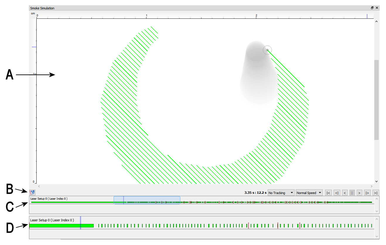

Choose to show or hide the smoke simulation window.
When there is suitable data available, then the smoke simulation window shows the result of the smoke simulation. It is empty when smoke simulation is disabled (in the smoke simulation settings of the project properties), when there is no suitable data available in the exposure preview, or when the timeline is too short.

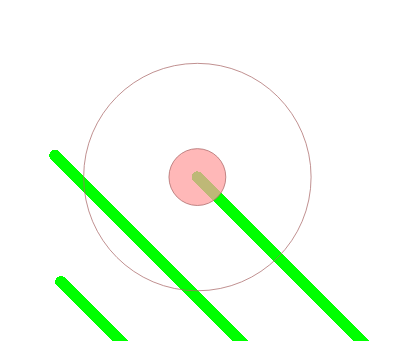

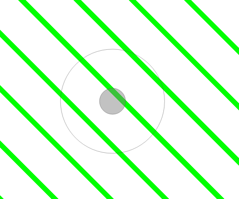

Gray circle: laser is off |
Red circle: Laser is on |

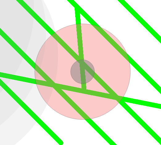

Large red circle: Smoke-Laser-Collision detected in the time interval |

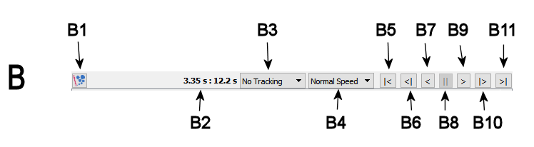

The smoke simulation toolbar gives access to commands related to the smoke simulation.
The upper area C displays an overview of the complete timeline for all the lasers.
The lower area D displays the part of the timeline highlighted by the focus rectangle (C1, in highlight color) in the upper area C.
Move the focus rectangle C1 in the upper area C by dragging it left and right. This also moves the timeline. Adjust the size of the focus rectangle using the mouse wheel. Any change of size and/or position of the focus rectangle is reflected immediately in the lower area D.
In area C and D, the activity periods for each laser are drawn. Also, the current position on the timeline is indicated by a semi-transparent vertical line (in darker highlight color, e.g. C2 in area C). When a laser-smoke collision is detected, then a semi-transparent red line is drawn at the end of the related time interval (the collision is also indicated in the 2D visualization A).
Change the current position on the timeline by clicking on the timeline in area C or D.
