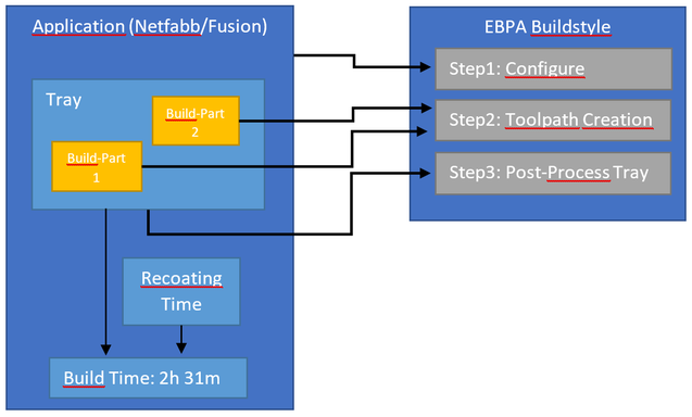

The following diagram shows the workflow and interaction between the Application and an EBPA buildstyle. The information is reduced to focus on the things which are relevant for build time estimation.
The EBPA buildstyle is responsible for creating the toolpaths and therefore also for estimating the time which is spent to process the toolpaths on each layer.
There are two types of time estimation generated by the EBPA. The first one is related to each individual build part and does not consider traveling time in between different parts on the tray. The second time estimation is considering all build parts on the tray including traveling time in between build parts as well as considering the path order which may be changed/optimized at step 3.
For the tray build time the application is using the second more precise time-estimation and may add time which is spent in addition to the toolpath processing time, e.g. the recoating time for each layer.
The first per-part time estimation is used to build up a statistic of build parts with certain properties (volume, size, etc.) and the corresponding build time reported by the EBPA. With this information the application can guess a build time for a certain EBPA based on the properties of a 3d build part without calculating toolpaths.
Based on this the application can instantly present a guessed build time estimation for a tray based on 3D build parts and the selected EBPA. After toolpaths are created this guess will be replaced by the more precise toolpath-based time estimation.
