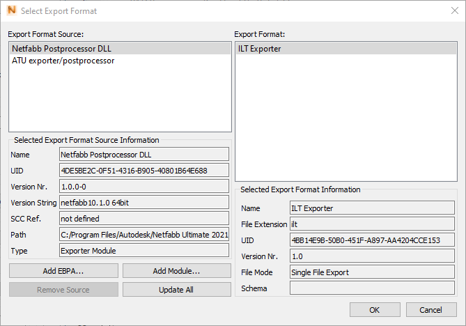

| Export data | |
| Use export function of current project | Uses an exporter that has been developed within the current project |
| Format | Select from formats the exporter provides. See table below. |
| Use external exporter | Uses an exporter that already exists and is known to ATU. |
| Export Target | The path to write the exported data to |
| Export format source | List of sources of all available export formats. A source can be a module (DLL) which provides compatible exporters or an EBPA providing exporters. |
| Selected export format source information | Information about the currently selected format source. That is mainly the type of source, version information and the location on disk. |
| Add EBPA | Select an EBPA file to add as a new source of export formats. |
| Add module | Add a module (DLL) to add as a new source of export formats. |
| Remove source | Remove the currently selected source from list. |
| Update all | Update information about all export format sources and export formats. |
| Export format | List of all available export formats within the selected export format source. |
| Selected export format information | Information about the currently selected export format. E.g. name, file extension, unique identifier, version info and schema. |
