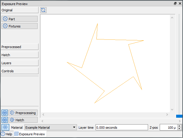

The example buildstyles don't use any meshes from the input geometry at all. The preprocessLayerStack function is used to construct geometry exclusively within the buildstyle. Of course, this isn't a real world example, but it is a good start to get familiar with Advanced Toolpath Utility's geometry concept.
All buildstyles will refuse to work, without having any input geometry, so it is necessary to load a geometry file even if it isn't used later on.

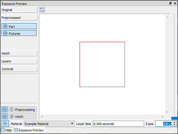

For a start, use the Advanced Toolpath Utility to open the first geometry example buildstyle at C:\ProgramData\Autodesk\ATU\ATU-Examples\tutorial-projects\geometry\01_2d-Geometry\. Now, open the Input Geometry Files widget and add the tree_sample_part.stl file as a part to the project. The layer thickness should be 100 micro meters. It can be found ZIP-compressed at C:\ProgramData\Autodesk\ATU\ATU-Examples\Geometry files\.
Hit Compile and check, if you can see a red rectangle at the exposure preview widget.

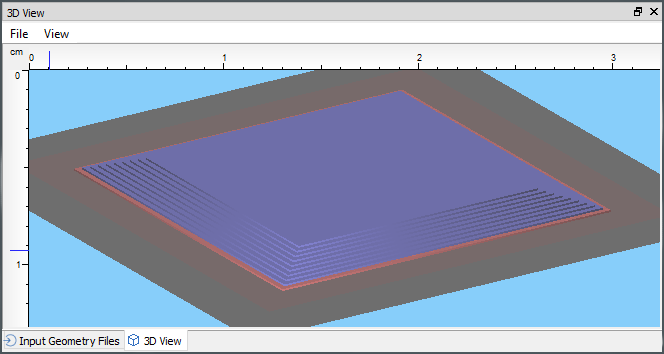

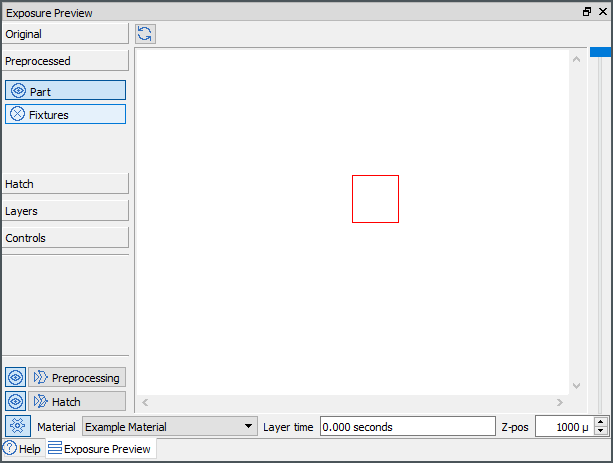

Examine Buildstyle Calculation Results
The exposure preview and the 3D view panel can be used to examine the calculation results. The exposure preview panel shows ten layers and their positions (preprocessed geometry has to be visible. Check the exposure preview's visibility options):
Cycling through the layers resizes the rectangle on the screen. The rectangle always gets a bit smaller on higher layers. The 3D view demonstrates this by showing a pyramid:

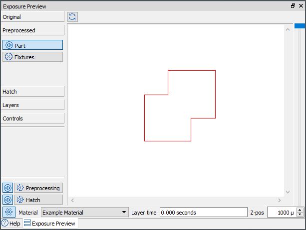

Clipping Operation
The buildstyle can be found at C:\ProgramData\Autodesk\ATU\ATU-Examples\tutorial-projects\geometry\02_Clipping\.
For the most part, this buildstyle is identical to the one above (01_2d-Geometry). It creates a model with ten layers and each layer contains a rectangle.
The new code is added as a new JavaScript file, called demonstration.js. For each layer the demonstration function is called after creating the rectangle. The constructed rectangle and the layer object are passed to the new function.
exports.demonstration = function(layer, rectangle)
  layer.addPathSet(rectangle, MODEL.nSubtypeSupport);
  var clippingRectangle = new PATH_SET.bsPathSet();
  var cPoint1 = new VEC2.Vec2(0.0, 15.0);
  var cPoint2 = new VEC2.Vec2(0.0,0.0);
  var cPoint3 = new VEC2.Vec2(15.0,0.0);
  var cPoint4 = new VEC2.Vec2(15.0,15.0);
  clippingRectangle.addNewPath(cPoint1,cPoint2,cPoint3,cPoint4);
  clippingRectangle.setClosed(true);
  var island = new ISLAND.bsIsland();
  island.addPathSet(clippingRectangle);
  //rectangle.clip(false, island);
  rectangle.clip(true, island);
  layer.addPathSet(rectangle, MODEL.nSubtypePart);
Functional Description (Step by Step)
The previously constructed rectangle is added to the layer as a support structure.
A new, intersecting rectangle is constructed:
The new rectangle is added to an island:

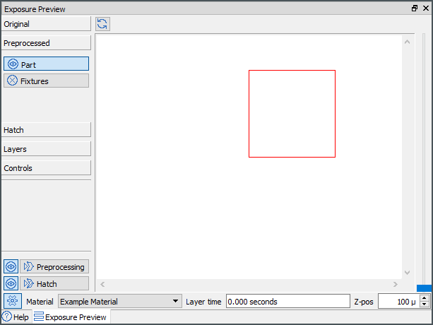

The clip operation is used on both rectangles. It allows to keep either the intersecting or the non intersecting area by passing either true or false as first parameter. The current example keeps the intersecting area.
The clipped rectangle is added to the layer as a part:
The exposure preview panel allows to show or hide part and support geometry. The Preprocessed section of the tab control on the left side can be used for this. Hiding the support structures (Fixtures) shows the clipped rectangle only:
Keeping intersected area Keeping non-intersected area

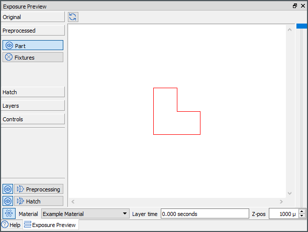

Boolean Operations
The buildstyle can be found at C:\ProgramData\Autodesk\ATU\ATU-Examples\tutorial-projects\geometry\03_Boolean-Operations\.
  var secondRectangle = new PATH_SET.bsPathSet();
  secondRectangle.addNewPath(cPoint1,cPoint2,cPoint3,cPoint4);
  secondRectangle.setClosed(true);
  rectangle.booleanOpUnify(secondRectangle);
  //rectangle.booleanOpSubtract(secondRectangle);
  //rectangle.booleanOpIntersect(secondRectangle);
One of three different boolean operations is used:
The processed rectangle is added to the layer as a part:
The exposure preview panel allows to show or hide part and support geometry. The Preprocessed section of the tab control on the left side can be used for this. Hiding the support structures (Fixtures) shows the processed rectangle only:
Unify Subtract Intersect

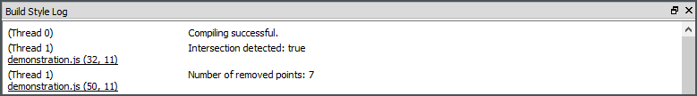

A new rectangle is added and the detectIntersection function is used to find an intersection:
var result = rectangle.detectIntersection(clippingRectangle);
A straight, non-closed polyline is added. This line contains unnecessary points, that will be removed by the reducePointsInTolerance function:
The reducePointsInTolerance function takes two parameters: reducePointsInTolerance and fEdgeLength.
The reducePointsInTolerance parameter defines the maximum deviation of a segment before and after removing a point. The point can be removed only if the deviation is smaller than specified:
The fEdgeLength parameter removes segments, which are smaller than the specified length.
The units of both parameters are millimeters and the reducePointsInTolerance parameter should be preferred because it produces better results. Points are removed only if one of the two tolerances will be underrun.

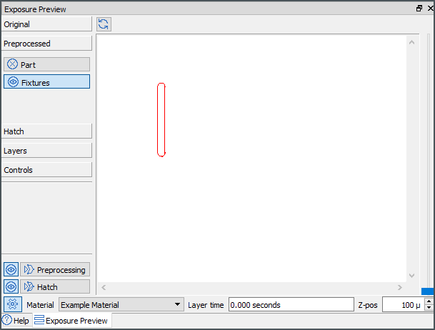

The last operation creates an offset around the open path and adds the offseted path as a support structure to the layer.
path.createOffset(0.5);
layer.addPathSet(path, MODEL.nSubtypeSupport);
The result of the intersection detection and the number of removed points are outputted to the buildstyle log:
The offset path is displayed at the exposure preview widget:

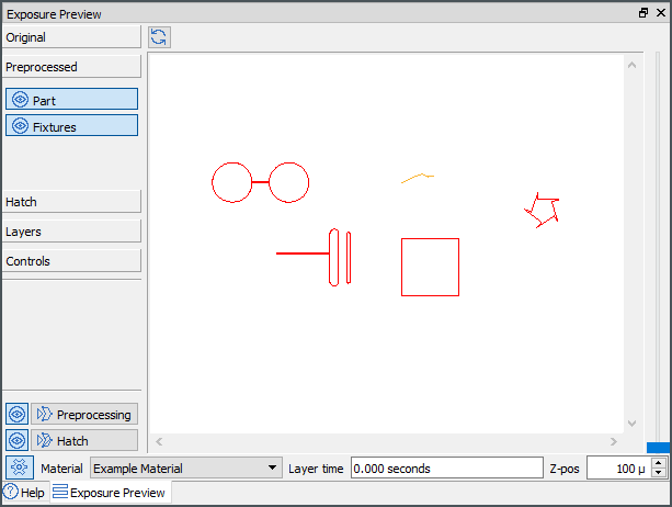

Test Geometry Buildstyle
The buildstyle can be found at C:\ProgramData\Autodesk\ATU\ATU-Examples\tutorial-projects\geometry\05_Hatch-Geometry\.
The new code is added as a new JavaScript file, called geometry.js. For each layer, the demonstration function is called. The layer object and the layer index are passed to the new function.
exports.createLayerGeometry = function(layer, layerIdx)
  createAMSensitiveStructure1(layer, layerIdx);
  createAMSensitiveStructure2(layer, layerIdx);
  createAMSensitiveStructure3(layer, layerIdx);
  createOpenPath(layer, layerIdx);
  createOffsetedPath(layer, layerIdx);
  createUFO(layer, layerIdx);
  createPyramid(layer, layerIdx);
This buildstyle does not use any new operations. It creates test geometry as a preparation for the following tutorial projects.
Exposure Preview 3D view
In and Outloops
The buildstyle can be found at C:\ProgramData\Autodesk\ATU\ATU-Examples\tutorial-projects\geometry\06_In-Out-Loops\.
For the most part, this buildstyle is identical to the one above (01_2d-Geometry). It creates a model with 10 layers and each layer contains a rectangle.
The new code is added as a new JavaScript file, called geometry.js. For each layer the demonstration function is called. The layer object and the layer index are passed to the new function.
  var path = new PATH_SET.bsPathSet();
  var points = new Array();
  // counter clock wise (Out-Loop)
  points.push( new VEC2.Vec2(64.90, -3.79));
  points.push( new VEC2.Vec2(62.81,  3.28));
  points.push( new VEC2.Vec2(65.19,  3.90));
  points.push( new VEC2.Vec2(57.81,  4.10));
  points.push( new VEC2.Vec2(57.95,  6.55));
  points.push( new VEC2.Vec2(55.48, -0.39));
  points.push( new VEC2.Vec2(53.19,  0.49));
  points.push( new VEC2.Vec2(59.04, -4.00));
  points.push( new VEC2.Vec2(57.48, -5.89));
  points.push( new VEC2.Vec2(63.57, -1.73));
// clock wise (In-Loop)
//   points.push( new VEC2.Vec2(64.90, -3.79));
//   points.push( new VEC2.Vec2(63.57, -1.73));
//   points.push( new VEC2.Vec2(57.48, -5.89));
//   points.push( new VEC2.Vec2(59.04, -4.00));
//   points.push( new VEC2.Vec2(53.19,  0.49));
//   points.push( new VEC2.Vec2(55.48, -0.39));
//   points.push( new VEC2.Vec2(57.95,  6.55));
//   points.push( new VEC2.Vec2(57.81,  4.10));
//   points.push( new VEC2.Vec2(65.19,  3.90));
//   points.push( new VEC2.Vec2(62.81,  3.28));
  path.addNewPath(points);
  //path.setClosed(true);
  layer.addPathSet(path, MODEL.nSubtypePart);
A path is created with two different point arrays and added to the current layer. The first array contains the points in a clockwise direction the second one in a counterclockwise direction.
For closed polylines the Advanced Toolpath Utility uses the point direction to differentiate between solid areas and holes. The following example shows a closed area (red) with a few holes inside (blue):
Using the array of clockwise arranged points, the exposure preview widget will be empty, because a hole is constructed without any solid area around it. The counterclockwise oriented point array will show a closed polygon:
