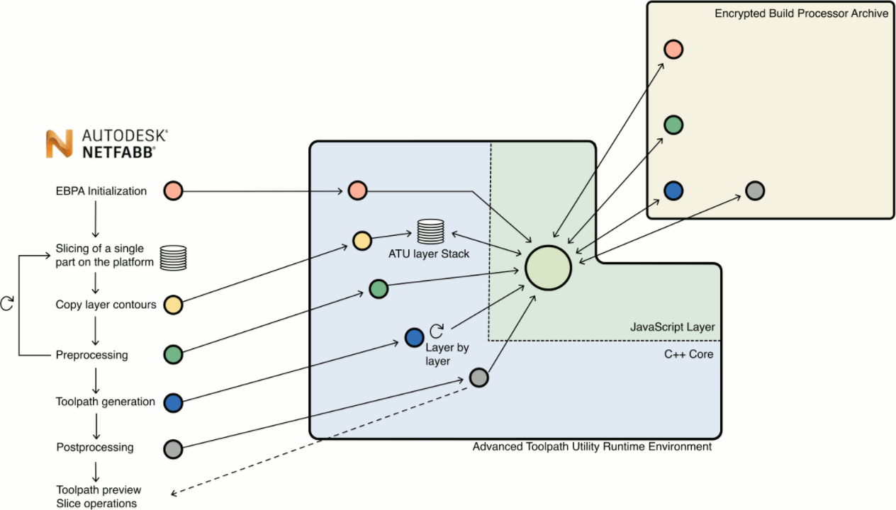

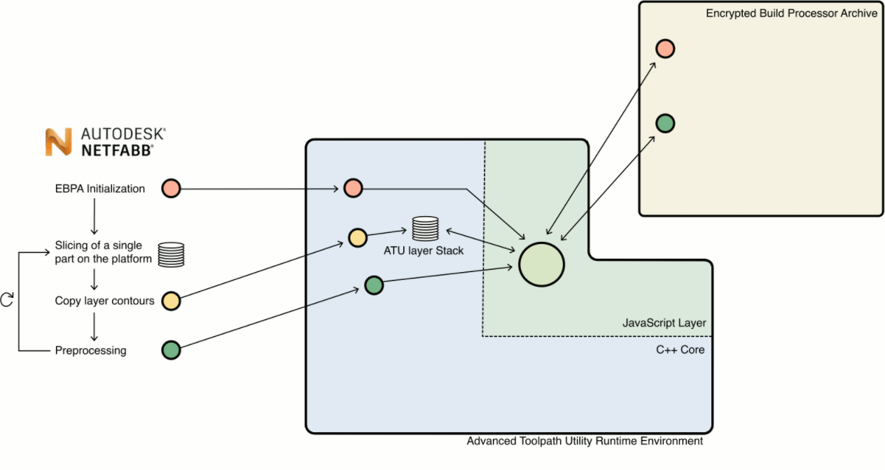

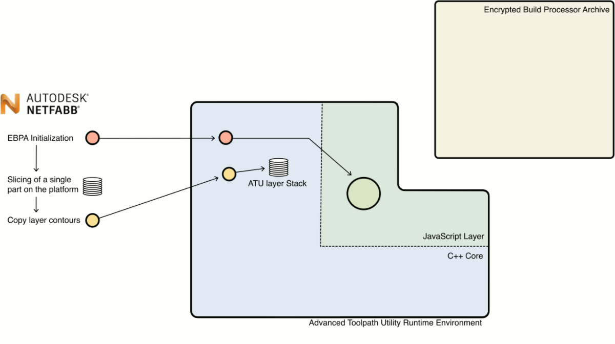

  1. An EBPA (Encrypted Build Processor Archive) file is loaded and initialized by the ATU runtime environment.
  2. Netfabb slicing generates contour data for the layers, one part at a time. This data is passed to the ATU runtime. Support structures for each part are usually passed as well, so that part and support contours are available on ATU side.
  3. During preprocessing, EBPA JavaScript code may manipulate contour data from the current part and/or its supports.
  4. After preprocessing for the whole platform, the toolpaths are generated layer by layer.
  5. The postprocessing step is called. It provides access to toolpath vectors for all parts and layers. This may be used to rearrange their order, for example.
  6. For toolpath previews within Netfabb, the toolpaths are transferred back.

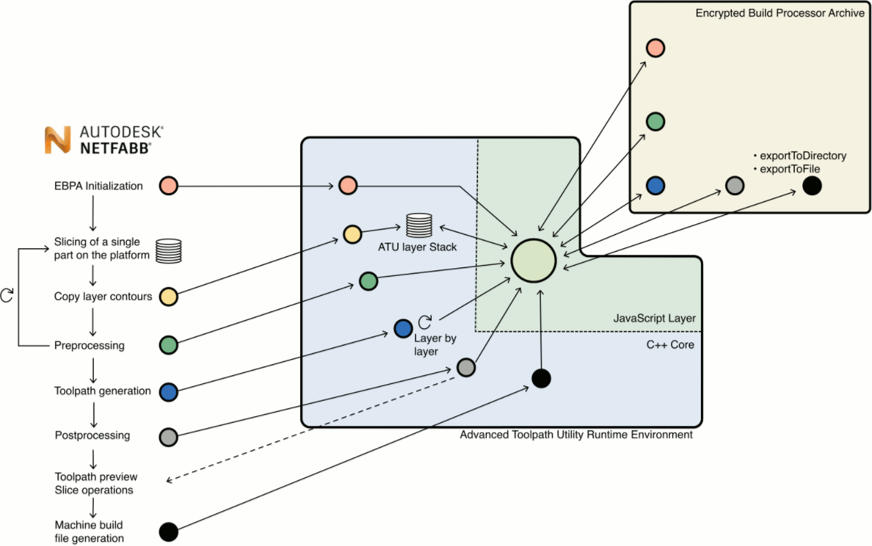

  7. The toolpath vectors and attributes are used to generate machine buildfiles.

Any slicer can be used with the ATU runtime. In case of Netfabb, the Netfabb slicer module creates layer contour data from each part on the platform. These contours are transferred to the ATU runtime and they are saved to an ATU layer stack. This layer stack is the central database for all contours and toolpaths. All following operations query, add, modify or delete data on this central data storage.
Preprocessing
At this stage, customized JavaScript code can be used to analyze, add, modify or delete layer contour data from a part and its supports.
Toolpath generation
Toolpaths are generated by a thread at the ATU runtime environment. For every layer the makeExposureLayer javascript function is called to generate toolpaths for each layer.
Postprocessing
The postprocessing step is the first place, where contours and toolpaths of all parts and all layers are available. It is commonly used to create the overall processing order of all toolpath vectors. The postprocessed toolpath data can be used to create toolpath previews or it can be used for further processing at Netfabb slicing.
Machine buildfile creation
Similar to the postprocessing step, all toolpaths of all layers can be accessed here to generate machine/vendor-specific buildfiles.
