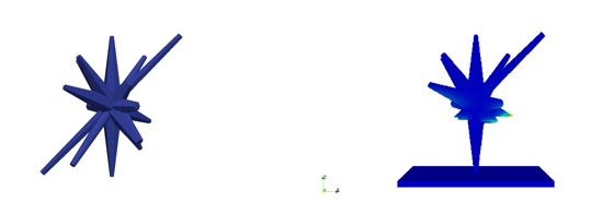

disconnected-element-number## Loose or rotating elements removed
This warning indicates the numbered element cannot be solved because it is not connected to the existing part or substrate, or not provided with support structures. The result would be a non-physical floating mass, so the element has been removed from the mesh for analysis.
Disconnected elements
In the figure on the left, you see a complex part. On the right is the solved simulation. Unsupported elements radiating downward have been removed because they could not be built from the bottom up. Rotating the build volume or adding support structures can eliminate these warnings.
