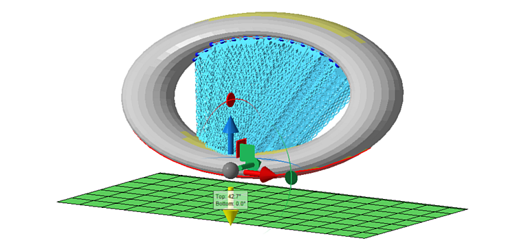

Creating part-to-part support by regenerating them on a specified target upskin (left)
Projecting volume supports estimates appropriate values for Stand angle and the knee function from position and size of upskins
Using upskin definition
