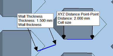

| Cell size |
Determines the length of the individual cells' inner sides. |
![]() Set wall thickness and cell size to adjust the grid pattern to your needs. |
| Wall thickness |
Adds a spacing between the cells. |

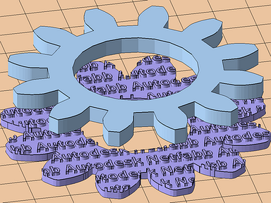

When the build room contains more than one part, and you select Custom Mesh for the Baseplate Type, you select the baseplate mesh here. |
![]() A spur gear with a baseplate stenciled from a custom mesh |
