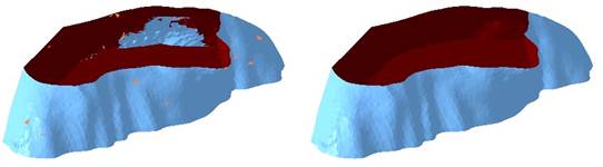

Reduce a mesh to a surface formed by only its outermost shells and discard any internal structures
When you have a part with multiple interior shells, it can be useful to wrap the exterior surface with a shell and delete the mesh inside the part to eliminate unnecessary complexity.
This command is only available in the context view, by using the script action, or through the context menu.
Wrap Part Surface.
Left: Part with interior shells. Right: After the wrapping operation, only the outer shells remain.
Remove Problem Areas command to scan the part for these areas and remove the intersecting triangles. You may then have to repair holes left behind before continuing with the wrap operation.
