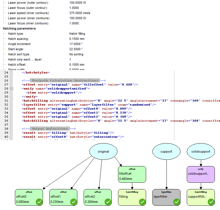

To define build strategies, meaning which algorithms to use, what values their parameters have, and how they are chained together to generate the toolpaths, Netfabb's native support for powderbed-style machines uses XML. This XML definition is exposed in three variants:
| Type | User-definable | Can be converted to | |
| Simple | Exposes a selection of parameters from the XML definition with drop-downs and input fields. The actual selection and arrangement of algorithms is hidden. | No | No |
| Programmable | Exposes the XML definition code for editing in the built-in text editor | Yes | Yes |
| Diagram | Visualizes the XML definition in the built-in visual programming editor | Yes | Yes |
(EBPA, or Encrypted Build Processor Archive, is a fourth method that is similar to Simple in how it looks but is defined in JavaScript using Autodesk® Advanced Toolpath Utility for Netfabb® and is not treated here.)
The types Programmable and Diagram can be converted to, and between, so that you can observe how changes in code or in visual arrangement are reflected in the respective counterpart. For Simple, this is a one-way conversion; however, any customisation you make to a simple-type configuration is reflected in the generated XML code.
The same strategy in Simple form (excerpt), in XML code (excerpt), and in graphical visualization (side panel for configuring not shown)
