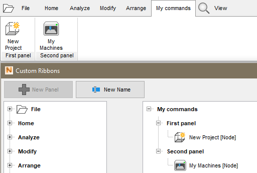

Add and adjust your own tab of commands in the main menu
To begin, choose from the main menu.
The menu holds commands in panels.
Add panels to the menu tab first, then add commands from the list to panels.
To add a panel, select the menu name first, then click New panel, provide a name, and click OK.
To
add a command, select the panel, then select the command on the left, then click
To
delete a command, panel, or entire custom menu, select it and click
Click Apply to accept the changes, or Cancel to discard them.
