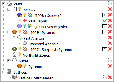

A hierarchical display of a project's contents
The project tree is a view in Netfabb. It lists all parts, slices, machine workspaces, other objects as well as loaded modules contained in a project, and it displays the relationship between these elements in tree-like fashion. For example, a module may be loaded on a part, and the loaded module is represented as a branch under the part.
Sorting and organizing
Accessing elements and functions
Indicating element status and properties
Example of parts, slices, and module branches loaded in the project tree.
yellow lightbulb icon which indicates the part is
visible. The
warning sign on the
display color swatch for
Screw_c2 indicates that it is considered to require
repair. You can also see that a
Part Repair operation has been opened for this part, and the
green tickmark next to it provides a shortcut to
apply any repair actions taken during the repair operation.
bluish lightbulb icon which indicates the part is hidden while the
colorwheel with a yellow lightbulb icon indicates that its
actual color is currently active instead of its display color.
group named
Screws.
multiple shells and also as having
no actual color or texture.
No-Build Zones: Parts under this node have the function of immovable placeholders that occupy space that mustn't be used by functions like automated packing. This is in addition to no-build zones that come with machine workspaces.
slice stack of
Pyramid has been created in the
Slices section of the default
Parts platform, and its
display color is orange.
Remove,
Add, and
Apply Part Repair, provide additional functionality.
