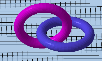

An example for two interlocking tori

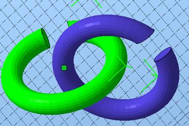

Two parts that are detected as interlocked, even though they could be separated
Found interlocks will leave all involved parts selected.
