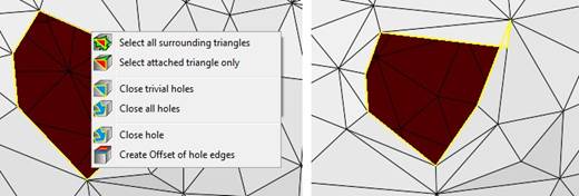

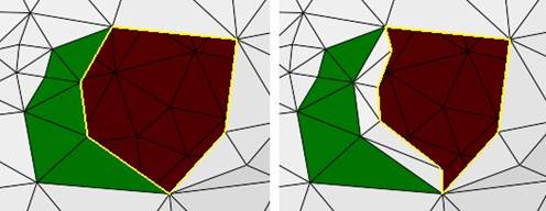

Generate new triangles along hole edges to cover a specifiable distance
When you offset hole edges, new triangles are inserted at the border edges around the hole. These triangles are created in the same plane as the adjacent triangles.
Create Offset of Hole Edges.
Left: Original mesh. Right: An offset of 1 mm is created.
Left: A selection of triangles before the offset. Right: The resulting offset.
