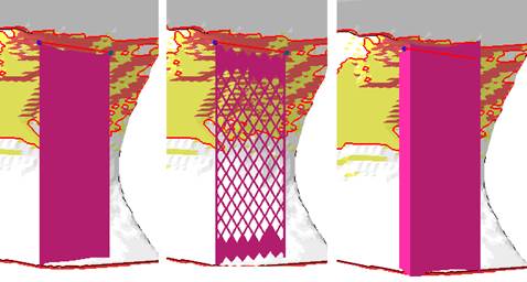

Polyline type
Sets the type of polyline.
From left: Open wall, open structure, closed wall

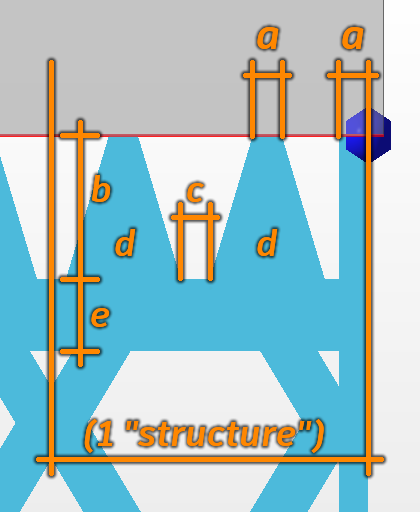

Connection
Top part Refers to supports terminating in part surface at its top end.
Bottom part Refers to supports terminating in part surface at its bottom end.
Platform Refers to supports terminating in the platform surface at its bottom end.
Connection property
Connection
Type of connection
Select from: Strip, Trapoid, Breaking Points, Triangles.
  • Strip: A continuous band connecting to the part all along its upper edge
  • Trapoid: Triangles with truncated tips
  • Breaking points: Like trapoid, but with another, inverted row of trapoids stacked on top, forming X-shaped connections
  • Triangles: Triangles that simply terminate in corners, for very delicate support attachment
Connection width
a
Connection properties
  • Does not apply to Strip.
  • For Triangles, this only applies to the vertical line at the beginning for the polyline, or contour.
  • For Breaking Points, this is the "waist" of the X-shaped connections.
The width of the vertical strip on the far right can be overridden. See Structure Properties > Border width.
Connection height
b
  • For Strip, b and e are simply cumulative.
Pin distance
c
Pins per structure
d
Distance connection to structure
e
