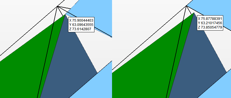

Fully separate shells that currently share nodes with each other
The manufacturing of a part can be problematic when multiple shells share the same node. The Sanitize Duplicate Nodes repair action creates individual nodes for each shell.
New Script.
Left: Two shells sharing a node. Right: Two shells with unique nodes.
