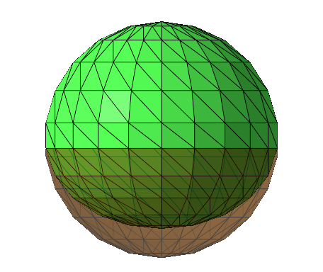

An exaggerated example of Z-compensation. The brown transparent section indicates the original shape.

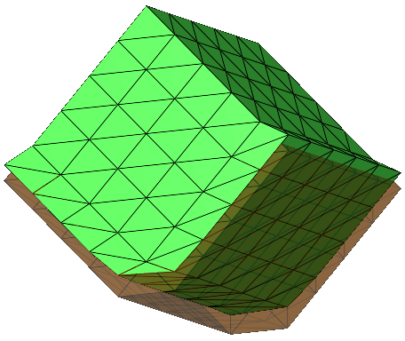

An exaggerated example of distorted edges. The brown transparent section indicates the shape before Z-compensation.
