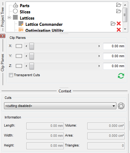

Rearrange or detach the views that make up Netfabb's window to suit your space and display preferences
Netfabb's user interface consists of several panes, or views, arranged in a window layout. The layout of the interface can be adjusted by resizing, repositioning, stacking, even detaching the different views that make up the interface. This can be especially useful on a multi-monitor workplace.
Click
and select from
Default,
Classic, and
Center.
splitter handle as desired.
The layout is saved when you close Netfabb, and you choose to lock the views by toggling again.
