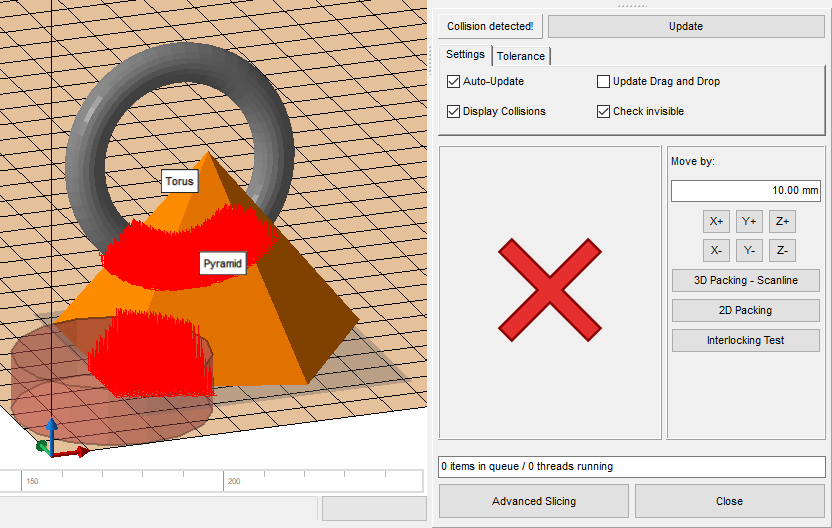

  1. From the main menu, choose Analyze > Collision Detection.
This performs an initial check. You may want to adjust the settings to fit your workflow and triangle count if the impact on performance is unsuitable to keep the check updated automatically when rotating or moving the part around.
The density of the collision indicator lines is set by the Resolution parameter on the Tolerance tabsheet, and their color is defined in the settings.

These controls appear in the context view as you use collision detection.
Control Description Range
Update
If any automatic update of collision checking is disabled, say, for performance reasons, use this button to update the check manually.
Auto-update
Reruns the collision check every time a part's position, size, or orientation is changed.
Update Drag and Drop
Reruns the collision check during rotation or moving while the mouse button is still held down.
Display collisions
When ticked, Netfabb renders a 3D grid over the intersecting area. When unticked, collisions are only indicated by the warning symbol, red X or green tickmark.
Check invisible
When unticked, hidden parts are disregarded in the collision check.
Move by
Use these controls to adjust the position in increments in X, Y, and Z directions.
