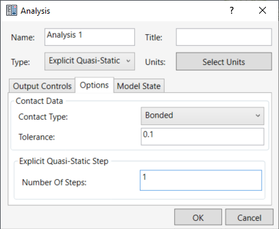

In the
Analysis
dialog, click the
Options
tab, and under
Explicit Quasi-Static Step
, ensure that the
Number of Steps
value is 1.
Click
OK
to close the dialog.
