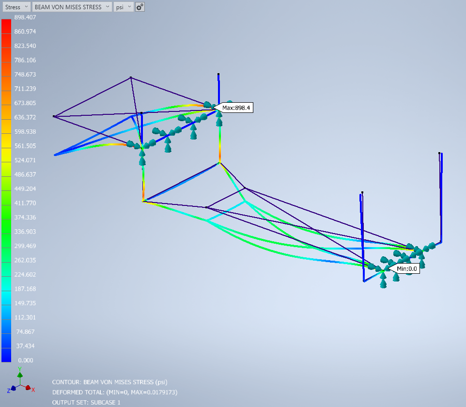

Finally, we can complete the rule by adding a command to create a contour plot after the solution is complete.
  1. Copy the following text:
    strCmdForDisplayContour = "<Contour ID=""1""/>"

  3. Switch back to the iLogic browser, right-click in the white space of the browser and choose Run All Rules.
  4. If you receive a warning about multiple idealizations, click OK.
  5. Click OK when the solution is complete to view the contour plot.
