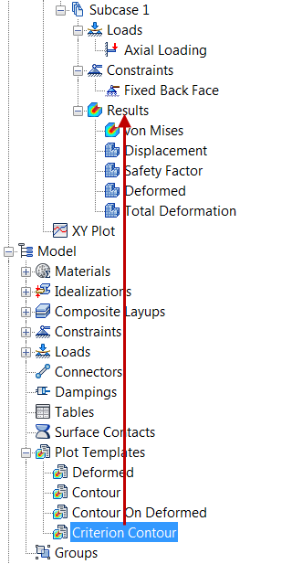

  1. Double-click von Mises plot.
  2. Drag and drop a Criterion Contour template onto Results, as shown in the image below, from the Plot Templates section of the tree.
  3. The template is placed at the bottom of the Results under Subcase 1.
  4. Right-click on the new template and choose Edit to change some settings in the plot.
