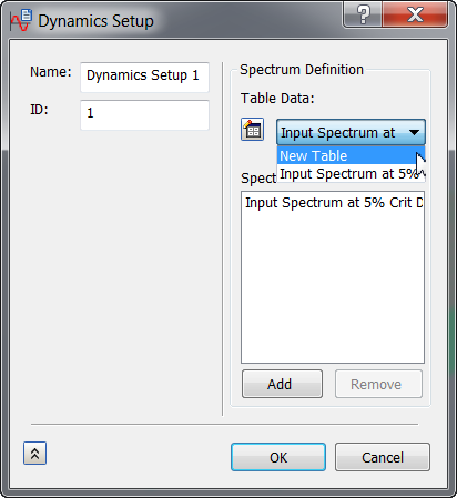

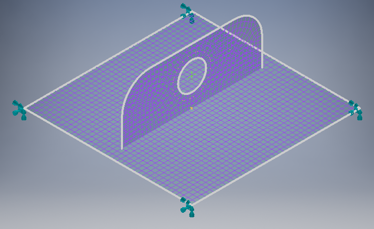

By default the constraint is set to Fixed condition, so all 6 degrees of freedom of the nodes on the selected surface are constrained.
icon to open the
Table Data dialog.

The name of your new table should appear in the Spectrum Curve List. We will add two more tables with different critical damping values.
