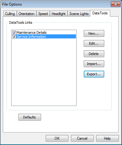

Export a Database Link
  1. Click Home tab > Project panel > File Options .
  2. In the File Options dialog box > DataTools tab, click the link you want to export in the DataTools Links area, and click the Export button.
  3. In the Save As dialog box, browse to the desired folder, and enter a name for the datatools file. You can also select the name of an existing datatools file to overwrite it with your modified configuration.
  4. Click Save.
  5. Click OK to close the File Options dialog box.
