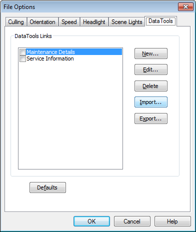

Import a Database Link
  1. Click Home tab > Project panel > File Options .
  2. In the File Options dialog box > DataTools tab, click the Import button.
  3. In the Open dialog box, browse to the folder containing the required datatools file, select it, and click Open.
  4. Click OK to close the File Options dialog box.
