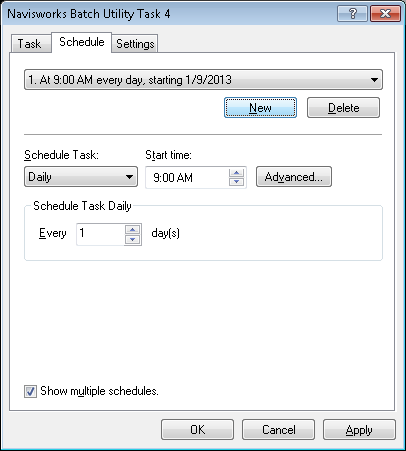

  5. In the Schedule Task dialog box, change the task name, if required, and enter your user name and password. Click OK.
    In the Windows Task Scheduler, the Schedule tab, click the New button, and specify when and how often the task is to run. You can add as many schedules as necessary.
  6. Click OK.
